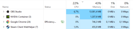

I've been trying to troubleshoot an issue with OBS using 13+ GB of Memory on my computer, without even running a stream or recording.
Tried clearing Caches, cleaning up scenes and sources, but am struggling to see where it's using all the memory.
I'm struggling to come up with what the possible solutions could be.

Does the problem persist if you remove the streamlements plugin from your install?
I just uninstalled it, and unfortunately, it still runs at an outrageous high amount of memory.
I will run a test stream again, and see if it crashes with all the other issues, but the log files quickly become too large to upload here.

In the task manager, click the > in front of the OBS icon to expand the child processes. Are there multiple processes listed? If one of these is obs-browser-page.exe, then it's one of your browser sources or browser docks, not OBS itself.
The Task manager just has the process of "OBS 30.2.3 - Profile: Blunding - Scenes: Untitled" listed when I expand it. I expected it to be a browser source or similar taking up a bunch of my use, but I have tried to minimize the use of plugins more and more, to easier be able to troubleshoot if stuff like this happened. At the same time I cleared the Cache.
Not sure if this cached memory could be one of the reasons too? Would media and Image sources take up this much memory?

UPDATE:
I have ticked unloading of my sources, when not showing, which helped bring me down towards "only" 4 GB of ram usage atm, so definitely found a big sinner there. I don't know if this will affect timings of everything
