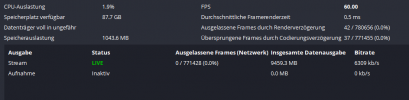

Didnt change much for me between different drivers. Had this thing going on since i started streaming (months ago). I dont know. The fps loss isnt that bad. I was just expecting to be able to stream at high settings with more than 144 fps in most of the games. Seems like that this isnt the case.
Those are the stats that i have while streaming and playing mc e.g. I guess that isn't so bad because it's zero percent everywhere and nothing goes red.
